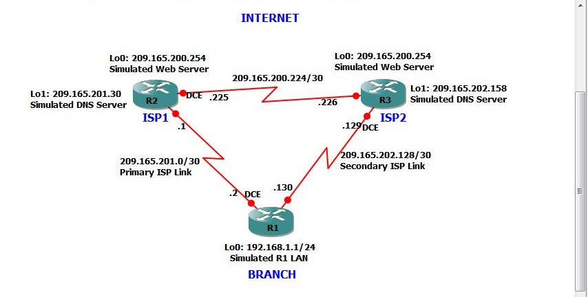

        Sơ đồ mạng để làm lab IP SLA

          Cấu hình:
          version 12.4
          service timestamps debug datetime msec
          service timestamps log datetime msec
          hostname R1
          boot-start-marker
          boot-end-marker
          no aaa new-model
          memory-size iomem 5
          ip cef
          no ip domain lookup
          ip sla monitor 11
          type echo protocol ipIcmpEcho 209.165.201.30
          frequency 10
          ip sla monitor schedule 11 life forever start-time now
          ip sla monitor 22
          type echo protocol ipIcmpEcho 209.165.202.158
          frequency 10
          ip sla monitor schedule 22 life forever start-time now
          track 1 rtr 11 reachability
          delay down 10 up 1
          track 2 rtr 22 reachability
          delay down 10 up 1
          interface Loopback0
          description Simulated R1 LAN
          interface FastEthernet0/0
          no ip address
          shutdown
          duplex auto
          speed auto
          interface FastEthernet0/1
          no ip address
          shutdown
          duplex auto
          speed auto
          interface Serial1/0
          description R1----->ISP1
          bandwidth 128
          ip address 209.165.201.2 255.255.255.252
          serial restart-delay 0
          clock rate 128000
          interface Serial1/1
          description R1------>ISP2
          bandwidth 128
          ip address 209.165.202.130 255.255.255.252
          interface Serial1/2
          no ip address
          shutdown
          interface Serial1/3
          no ip address
          shutdown
          no ip http server
          ip forward-protocol nd
          ip route 0.0.0.0 0.0.0.0 209.165.201.1 2 track 1
          ip route 0.0.0.0 0.0.0.0 209.165.202.129 3 track 2
          ip route 0.0.0.0 0.0.0.0 209.165.201.1 5
          control-plane
          line con 0
          exec-timeout 0 0
          logging synchronous
          line aux 0
          line vty 0 4
          login
          end
          version 12.4
          hostname ISP1
          boot-start-marker
          boot-end-marker
          no aaa new-model
          memory-size iomem 5
          ip cef
          no ip domain lookup
          interface Loopback0
          description Simulated WEB Server
          ip address 209.165.200.254 255.255.255.255
          interface Loopback1
          description Simulated DNS Server
          ip address 209.165.201.30 255.255.255.255
          no ip address
          shutdown
          duplex auto
          speed auto
          no ip address
          shutdown
          duplex auto
          speed auto
          interface Serial1/0
          description ISP1---->R1
          bandwidth 128
          ip address 209.165.201.1 255.255.255.252
          interface Serial1/1
          description ISP1---->ISP2
          bandwidth 128
          ip address 209.165.200.225 255.255.255.252
          clock rate 128000
          interface Serial1/2
          no ip address
          shutdown
          interface Serial1/3
          no ip address
          shutdown
          router eigrp 1
          network 209.165.200.224 0.0.0.3
          network 209.165.201.0 0.0.0.31
          no auto-summary
          no ip http server
          ip route 192.168.1.0 255.255.255.0 209.165.201.2
          control-plane
          line con 0
          exec-timeout 0 0
          logging synchronous
          line aux 0
          line vty 0 4
          login
          end
          version 12.4
          hostname ISP2
          boot-start-marker
          boot-end-marker
          no aaa new-model
          memory-size iomem 5
          ip cef
          no ip domain lookup
          interface Loopback0
          description Simulated Web Server
          interface Loopback1
          ip address 209.165.202.158 255.255.255.255
          no ip address
          shutdown
          duplex auto
          speed auto
          no ip address
          shutdown
          duplex auto
          speed auto
          interface Serial1/0
          description ISP2----->R1
          bandwidth 128
          ip address 209.165.202.129 255.255.255.252
          clock rate 128000
          interface Serial1/1
          description ISP2----->ISP1
          bandwidth 128
          ip address 209.165.200.226 255.255.255.252
          interface Serial1/2
          no ip address
          shutdown
          interface Serial1/3
          no ip address
          shutdown
          router eigrp 1
          network 209.165.202.128 0.0.0.31
          no auto-summary
          no ip http server
          ip route 192.168.1.0 255.255.255.0 209.165.202.130
          control-plane
          line con 0
          exec-timeout 0 0
          logging synchronous
          line aux 0
          line vty 0 4
          login
          end
            Do làm trên GNS3 nên câu lệnh về IP SLA nó cũ hơn so với những ISO version sau này.
            FYI, trong này cũng có nhiều labs, bạn tham khảo thêm nhe: http://gns3vault.com/Labs/all/
            Hope it helps
