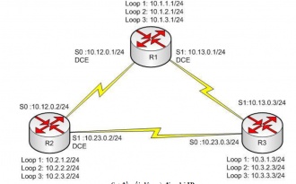

    Các pro giải thích dùm em cấu hình OSPF bài lab này với.Sao network và wicarlmax của R1,R2,R3 lại có như vậy?Thanks!

    - Tại R1 ta cấu hình như sau:
    r1(config)#router ospf 100
    r1(config-router)#net 10.12.0.1 0.0.0.0 a 0
    r1(config-router)#net 10.13.0.1 0.0.0.0 a 0
    r1(config-router)#net 10.1.1.1 0.0.0.0 a 0
    r1(config-router)#net 10.1.2.1 0.0.0.0 a 0
    r1(config-router)#net 10.1.3.1 0.0.0.0 a 0
    -Tại R2 cấu hình như sau:
    r2(config)#router ospf 200
    r2(config-router)#net 10.23.0.0 0.0.0.255 area 0
    r2(config-router)#net 10.12.0.0 0.0.0.255 area 0
    r2(config-router)#net 10.2.1.0 0.0.0.255 area 0
    r2(config-router)#net 10.2.2.0 0.0.0.255 area 0
    r2(config-router)#net 10.2.3.0 0.0.0.255 area 0
    -Tại R3 cấu hình như sau:
    r3(config)#router ospf 300
    r3(config-router)#net 10.0.0.0 0.255.255.255 area 0
    - Show R1:
    r1#sh ip route
    10.0.0.0/8 is variably subnetted, 12 subnets, 2 masks
    C 10.12.0.0/24 is directly connected, Serial0
    C 10.13.0.0/24 is directly connected, Serial1
    O 10.3.2.3/32 [110/65] via 10.13.0.3, 00:00:18, Serial1
    O 10.2.2.2/32 [110/65] via 10.12.0.2, 00:00:18, Serial0
    C 10.1.3.0/24 is directly connected, Loopback3
    O 10.3.3.3/32 [110/65] via 10.13.0.3, 00:00:18, Serial1
    O 10.2.3.2/32 [110/65] via 10.12.0.2, 00:00:18, Serial0
    C 10.1.2.0/24 is directly connected, Loopback2
    C 10.1.1.0/24 is directly connected, Loopback1
    O 10.3.1.3/32 [110/65] via 10.13.0.3, 00:00:19, Serial1
    O 10.2.1.2/32 [110/65] via 10.12.0.2, 00:00:19, Serial0
    O 10.23.0.0/24 [110/128] via 10.12.0.2, 00:00:19, Serial0
    [110/128] via 10.13.0.3, 00:00:19, Serial1
    Show R2:
    r2#sh ip route
    O 10.13.0.0/24 [110/128] via 10.12.0.1, 00:00:22, Serial0
    [110/128] via 10.23.0.3, 00:00:22, Serial1
    O 10.3.2.3/32 [110/65] via 10.23.0.3, 00:00:22, Serial1
    O 10.1.2.1/32 [110/65] via 10.12.0.1, 00:00:22, Serial0
    O 10.3.3.3/32 [110/65] via 10.23.0.3, 00:00:22, Serial1
    O 10.1.3.1/32 [110/65] via 10.12.0.1, 00:00:22, Serial0
    C 10.2.1.0/24 is directly connected, Loopback1
    C 10.2.2.0/24 is directly connected, Loopback2
    O 10.3.1.3/32 [110/65] via 10.23.0.3, 00:00:23, Serial1
    O 10.1.1.1/32 [110/65] via 10.12.0.1, 00:00:23, Serial0
    C 10.2.3.0/24 is directly connected, Loopback3
    C 10.23.0.0/24 is directly connected, Serial1
    Show R3:
    r3#sh ip route
    O 10.12.0.0/24 [110/128] via 10.13.0.1, 00:00:12, Serial1
    [110/128] via 10.23.0.2, 00:00:12, Serial0
    O 10.2.2.2/32 [110/65] via 10.23.0.2, 00:00:12, Serial0
    O 10.1.2.1/32 [110/65] via 10.13.0.1, 00:00:12, Serial1
    C 10.3.1.0/24 is directly connected, Loopback1
    O 10.2.3.2/32 [110/65] via 10.23.0.2, 00:00:12, Serial0
    O 10.1.3.1/32 [110/65] via 10.13.0.1, 00:00:13, Serial1
    C 10.3.3.0/24 is directly connected, Loopback3
    O 10.2.1.2/32 [110/65] via 10.23.0.2, 00:00:13, Serial0
    O 10.1.1.1/32 [110/65] via 10.13.0.1, 00:00:13, Serial1
    C 10.3.2.0/24 is directly connected, Loopback2
    C 10.23.0.0/24 is directly connected, Serial0

      Chào bạn,
      wildcard mask là nghịch đảo của subnet mask nên với bít nào là 0 thì quan tâm còn bit nào là 1 thì không cần quan tâm đến. Trên R1 của bạn quảng bá với wildcard mask là 0.0.0.0 nghĩa là OSPF sẽ được enable trên những interface có chính xác những IP bạn đưa vào, còn R2 dùng 0.0.0.255 nghĩa là những interface nào có ip thuộc trong những lớp mạng /24 bạn đưa vào sẽ enable OSPF và cuối cùng R3 của bạn cũng chỉ dùng 1 câu network duy nhất để quảng bá tất cả các interface thuộc trong mạng 10. Lưu ý mặc định khi là loopback OSPF sẽ quảng bá route /32 cho neighbor

        Mình đã hiểu như vậy là R3 sẽ quảng bá nhiều interface nhất ,nguyên mạng 10 luôn?
