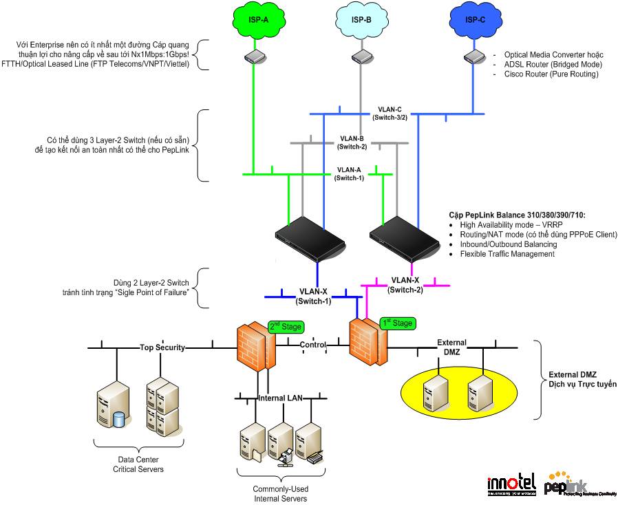

                              • http://cs.peplink.com/partners/resellers/Click image for larger version
